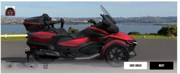

Just received word that my 2024 RT Limited has hit the warehouse. Hopefully can pick up soon.
