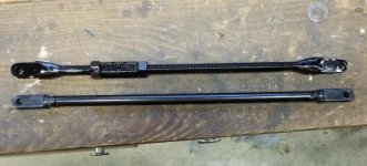

Biggest issue in tackling this is no frame of reference as to how much shorter the rod needs to be to change the position of the brake pedal. For that reason I decided to make the rod adjustable using a threaded rod and a coupler. I found out quickly that a very small change in the length of a rod made a much higher change in the position of the pedal. You can see from the pictures the rod I built has a hole position back about two-thirds of the diameter of the hole in the factory rod. So if somebody would want to drill a new hole in the factory rod it ain't going to work because you're going to cut into the existing hole.
The picture of the brake pedal is with the shortened rod in place and gives you an idea how much it dropped to Pedal.
