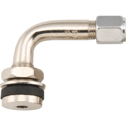

....If I understand you correctly ....you are looking for a re-placement valve stem that goes in the OEM hole and the goes up, turns and then goes thru the entire rim so you can access it from the other........... side ??????..............YOU ARE JOKING ......RIGHT !!!!!!...........That stem does not exist .........I drilled a NEW hole on the opposite side of the rim and put in a metal MTC 87 degree angled Valve stem in both my other Spyders .....I bought them on-line from Kurveygirl.com..( they are made by ENKIE )...2 @ $ + 2.50 shipping.........If you do this make sure you drill the hole at 1/2 inch inside the depressed line on the inside of the RIM so the TIRE mounting machine clears the valve ..................and I left the other stems in....I just filled them with silicone from the inside .................................Mikeguyver :thumbup:

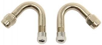

Perhaps these will accomplish what you are looking for:
...........If you have these mounted on your rear valve stem I would like to see a picture ....because I don't think there is enough clearance to the SPROCKET .........and even if it is, reaching across the rim from the disc side to un-screw the cap then to put any type of device on would be extremely difficult at best......JMHO.....Mikeguyver :thumbup:
I did not say I used them on the Spyder, but I do have them on the motorhome. You can find them in most any truck supply. Very common part for trucks with dual rear tires. Yes, they are extensions that thread on to the existing stem.
No idea if they would clear the sprocket on a spyder or be reachable from the right side.

:clap::clap::clap::clap::clap:​.......And I'm very Happy for you.........But Dr. Buck apparently does and I stand by my solution to Him regarding moving the VALVE stem to the opposite side as the only viable alternative IMHO......Annnnnnnnnd IMHO what works on your Motorhome is not going to work on the rear wheel of the Spyder for the reasons I gave..............Mikeguyver :thumbup:

:gaah::gaah::gaah::gaah:......I never said that stem ( as pictured by MagDave ) does not exist........It does exist and is SOLD by Kurveygirl as stated in my POST and I said to buy IT........WHAT I DID SAY ....WAS THERE IS NO STEM THAT WILL GO UP AND AROUND AND ACROSS THE ENTIRE RIM ....SO YOU CAN ACCESS IT FROM THE DISC SIDE .......and maybe " blueknight " said that .....but I'm BLUEKNIGHT911..........Mikeguyver

The picture posted by Magdave won't allow it. However, thanks to Magdave, when I have my rear tire replaced I will get that one.

I have one; but, it's not a good idea to leave on. After checking pressures, I remove it. What Lamont mentioned was that it will cause the rubber stem to flex and crack, if left on.
You are correct it is for filling and remove :thumbup:
