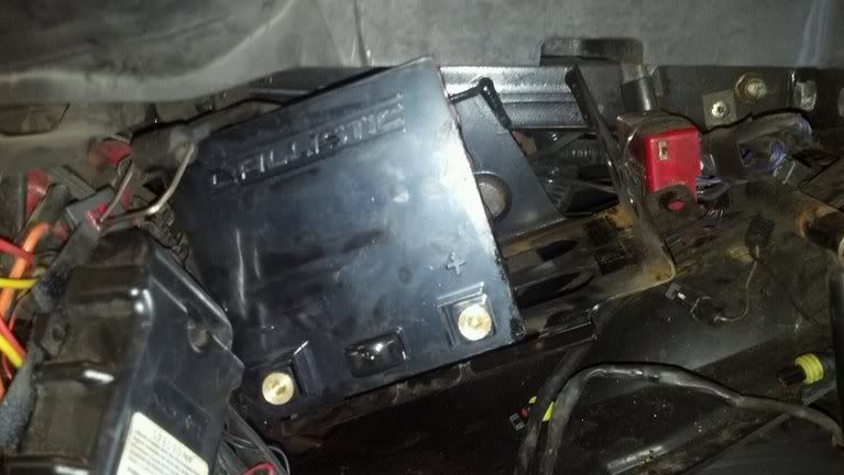

Those Ballistic batteries are showing up everywhere. They are Lithium-Ion and weigh a LOT LESS than a lead-acid battery!
I have these on my Spyder and yes you can charge them with a regular tender. I've been using these since May. I'm using the 36 amp battery which holds a lot more capacity. No problems with charging and fits great in the spyder. It weighs abut 5lbs and they give you some foam inserts that you can use to fit your existing box or space where your old battery use to sit in.
