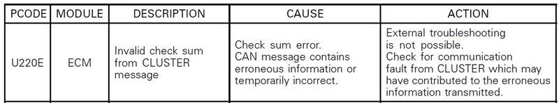

Hi! New to the forum and excited to start the Spyder journey! Yesterday, I bought a 2018 Can Am RT Limited and drove it home a couple hours. When I got home, I learned how to check codes (wished I knew how to do that before I paid for it lol) and there were no codes. Today, went out and was playing with the menus and there was a Fault Code u220E that I found when I was just playing with the menus again (there was no other indication or "check engine" etc).
I have searched high and low for a document that lists all the codes and what they refer to but only find broken links. Does anyone have this? The unit has only 1,200 miles on it and ran great, so not overly worried. I know I do need to get the "first service" done asap as it's been a few years regardless of little miles...
Thanks!
You will find them in the service manuals...
And welcome to the forums! I wouldn't be too concerned about that code.
thanks! Seems pretty random. Is there a .pdf manual or service manual that has all these? I'd like to have it for reference.
