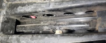

The sway bar fits inside a U-shaped channel. It passes thru a portion of the frame and is held in place in the channel by two plastic blocks. In some bikes, there is also a pair of retaining pins, but my bike did not have those. The end of the bars bends and connects via the links to the A-arm. The links need to be unbolted and removed, the blocks and retaining pins (if any) need to be unbolted. The blocks will drop out once the sway bar is wiggled loose from the channel.

Remove old sway bar 1.jpg This shows the plastic block and the bolt holding it in place. In this shot, the sway bar has been removed for illustration purposes.
Remove old sway bar 2.jpg Once the bolt is removed the plastic block will be loose. After both plastic block bolts are removed, the bar should be loose enough to remove the plastic blocks (slide them toward the wheel)
Remove old sway bar 3.jpg See the flat spot on the sway bar in the lower right corner? This needs to be aimed toward the ground when the Heim links are secured, so follow Ron's instructions for orienting the bar. Also, those flats needs to be equidistant from the plastic blocks on the inside of the blocks before tightening the block bolts back down.

Remove old sway bar 6.jpg The bar is hanging down at this point. Once the bike is jacked up high enough, it will just fall out.
Remove old sway bar 8.jpg In the center of the picture you can see the frame member above which the sway bar passes through.
