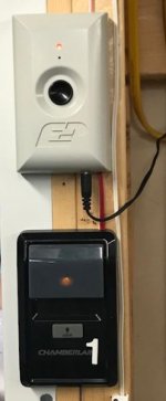

I added Flash2Pass to my 2012 RS-S Spyder a while back, was enjoying with the flick of light to close/open the garage when I left or get home. However, the opener went bad and I had to change. Purchased the Chamberlain 1.25 HP belt drive, installed it and found out that the Flash2Pass wouldn't work it anymore. Whenever the wall button on the Flash2Pass is pressed, it would reset the Chamberlain wall unit. I called Flash2Pass and technical guy said that the Flash2Pass works with almost anything but the Yellow antenna Chamberlain.
Well, read several other posts about the Flash2Pass, how-to, etc... and applied, they don't work together. Then I thought, when the wall button on the Chamberlain is pressed, basically it closes the contact, which is what the Flash2Pass button would do. However, the 2 Red/White wires in the back of the Chamberlain doesn't do that.
I then opened up the Chamberlain wall button unit and check on the continuity of the buttons, in pic 2.
Pic 3, the red circles are where the contact closes when the button is pressed. Wires can be soldered to either switch. I just happened to choose SW3.
Pic 4, back to the Flash2Pass wall plate, there is a switch that must be switched to N. Position S is to always close the contact Red and White. N position is to only close the contact when button is pressed.
Pic 5, put the Chamberlain wall plate back to the wall. Tested it out, still functions the same way it should
