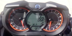

To disable the VSS on the f3S and the Daytona Model F3 (I have not been able to test other models so i do not know if this works on them, but i do not believe it does)
Press and Hold the MODE (eco) Button and the UP Arrow Button for three seconds and you will see a symbol appear next to the gear indicator on your screen, repeat the same sequence and the VSS will reengage and the symbol will disappear see photos below, this can be done from a stopped position or while you are moving.
VSS Active
VSS Disabled

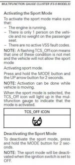

According to the Operator's manual, you missed some stuff.
Engine must be running.
No passenger.
No active fault codes.

The way I read it, the entire VSS is NOT disabled; only the TCS (Traction Control System).
You can do this with many cars today, also. But not the VSS.
