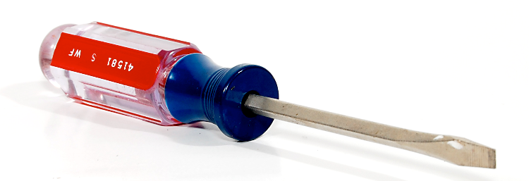

The magic screwdriver is the answer for removing the caps.
I have installed GloRiders on three bikes now. The first time I removed the wheels. I consider that a waste of time.
Now and for future installations: I put the ring in the mounted wheel--tighten the holding screws and just put everthing else together.
I can install them this way in about 10 minutes now.
I have never lost a GloRider with this method.
Screwdriver for the cap removal.
Allen wrench for the small set screws.
Phillips for the circut board screws.
3 AA batteries for the circuit board. They last me a whole season.
Favorite beverage to celebrate your succesful installation.

So you can still take the center cap off with a screwdriver without taking the wheel off?
