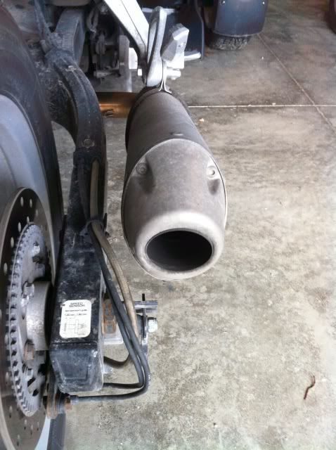

If it is a problem where the two pipes gets clamped down it might be ovaled (out of round). Mine was. Take it to a muffler shop and they have a tool to flare it out. If it is a problem where you mount it with the bracket, put the bracket to the OUTSIDE and it fits perfect. NO EXTRA PIPE IS NEEDED FOR THE INSTALL !!! I love my HMF pipe. If you need a pic of my install, let me know and I will post one.
Never mind. I'm posting pics of the install anyway for all you engineers that can't figure it out. Engineers crack me up !!! :roflblack::roflblack::roflblack: :joke:

I don't know what the issue some of you are having is, but if you put the bracket to the outside it doesn't even come close to the brakes or swingarm. Sorry about the dirty Spyder, I just got back from a 400 mile road trip.

If yours is mounted excatly like mine, there is a issue. As you can see in my photos, it does not even come close to the brake assembly. Even if you bottomed the shock out, it still would not hit. So weight has nothing to do with it. I ride 2 up all the time. Almost 300# worth of humans between my wife and I. It has to be a design difference in the pipe between yours and mine from HMF.

I see as I look more closely at your picture that you have that little aluminum spacer in yours. I installed it that way at first and it wasn't enough clearance, my muffler hit the parking brake. I tried a longer spacer and I didn't like how it felt when I tried to force things together that way.
