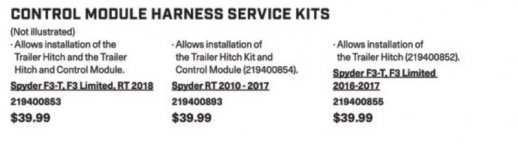

I built one for my STL some years ago. It's a lot easier now that BRP sells the Y-harness in their catalog for 39.99.
This is the one I want. So your saying 2018 and up RT and F3T and Limited all use the same harness. This would be the plug and play I'm looking for.
In the BRP catalog it lists what they call the module harness for S39.99. That is the Y-harness that splices into the Spyder main harness. Same part number for 2018 and later RT, F3T and F3L
