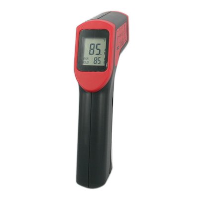

You can get a temp gun pretty cheap now days and it's a nice tool to have on hand. This way you could shoot the grip and see how much hotter it really is or isn't.
http://www.amazon.com/HDE-Temperature-Infrared-Thermometer-Laser/dp/B002YE3FS4

Alot of good thoughts, thank you. As far as switching hands, I did actually sit in the driveway with the spyder running while I crossed my arms and grabbed opposite grips. Just wanted tp make sure one hand wasnt more sensitive than the other. I will get the laser thermostat and so I have some real numbers.
Real Numbers
I got the laser thermometer, which is very accurate. The various sections of the handgrips fluctuate greatly, so these temps are from the hottest point of the grips. With the grip setting on high, left grip 161.4, right grip 191.6. Then I went to the low setting, and waited 5 minutes. Left grip 156.0, right grip 185.5.
