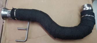

In another thread I showed how to remove the old Catalytic Converter (CC) from a 2014 RT. In this thread, I show the bypass pipe, the fiberglass tape I used to provide additional heat barrier to the pipe, and the optional baffle and plug (which I chose not to use).
The kit comes with the pipe, a tool used to remove (and replace) the springs holding the pipe to the engine exhaust, and the optional baffle and plug.
I bought some fiberglass exhaust pipe wrap which came with 6 metal ties. https://www.amazon.com/dp/B01KVYH66U?psc=1&ref=ppx_yo2ov_dt_b_product_details
I got the small tool for tightening the ties https://www.amazon.com/Design-Engin...59-9e60-46c82a9290c7&pd_rd_i=B00STU1UOI&psc=1
And I got a can of High Temp Silicone Coating https://www.amazon.com/dp/B000MY1RB0?ref=ppx_yo2ov_dt_b_product_details&th=1
With the pipe in a vise, I wrapped it with the fiberglass wrap and secured it with the 6 ties.
I then sprayed it with the High Temp Silicone Coating and when dry installed it under the Spyder, reversing the steps taken in the other thread on that topic. https://www.spyderlovers.com/forums...-Remove-Catalytic-Converter-(CC)-from-2014-RT
