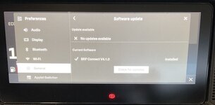

So of course I had to go check my 2024 Spyder RT to see if there were any updates available.
After connecting to my home Wifi network, I went into the Preference applet, chose General, and then Software update.
It displayed a message about connecting to my network, and then this is what showed up.
My Spyder is currently running BRP Connect V4.1.0, which is the latest version for it.
And of course I have to apologize for something I posted earlier, about BRP GO! and BRP Connect working on the older 7.8" displays.
BRP GO! is for the older bikes with the smaller displays, but BRP Connect is still the connection component that runs on the Spyder.
