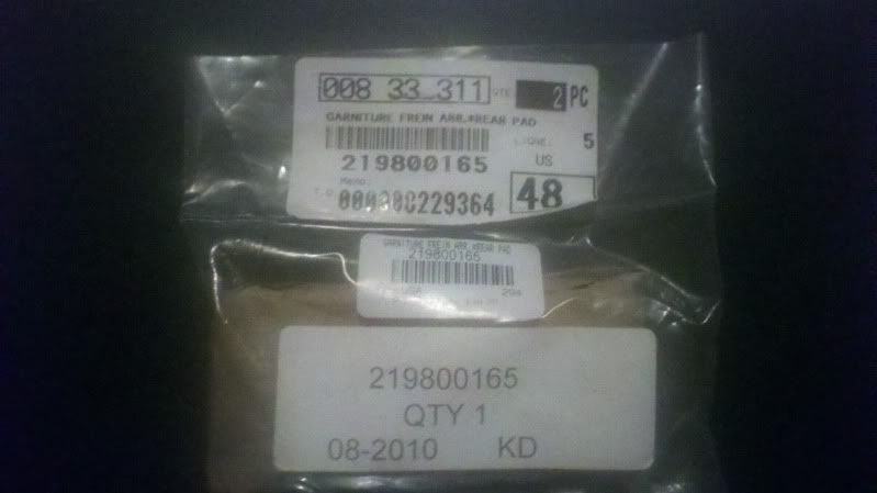

Rear, Gen.3, August 2010:

Looks like the Gen 3 numbers are:
Fronts: (4 pad kit) 219 800 164
Backs: (2 pad kit) 219 800 165

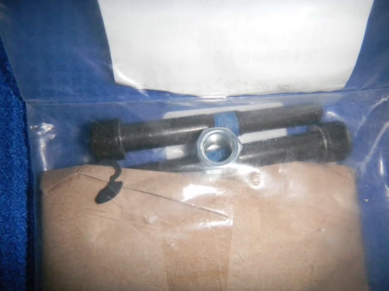

This is your package:
It was a little difficult getting the piston compressed enough to give you room to drop in the new pads. There isn't much space. It was also a bit of a pain getting the clips on the caliper bolts.
