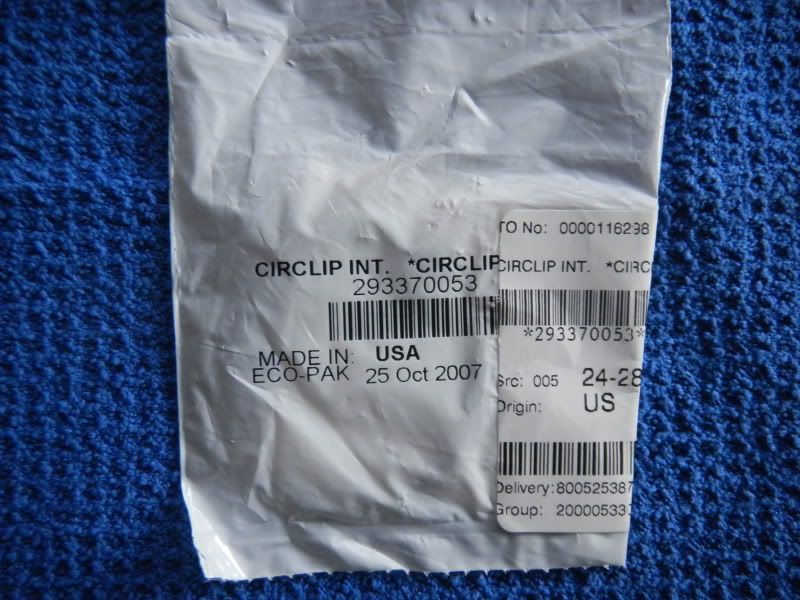

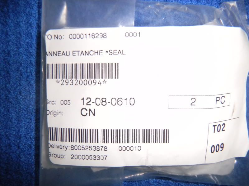

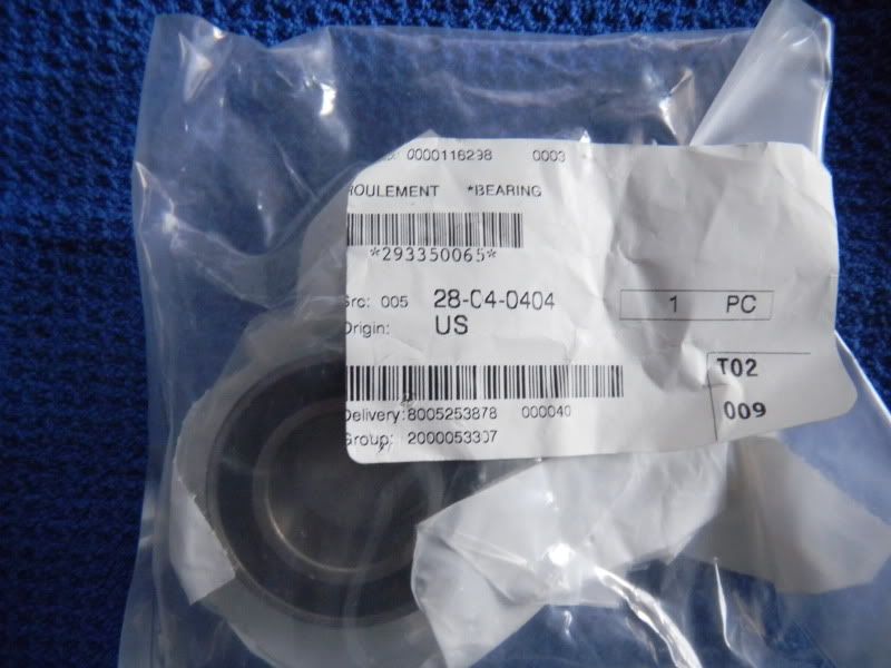

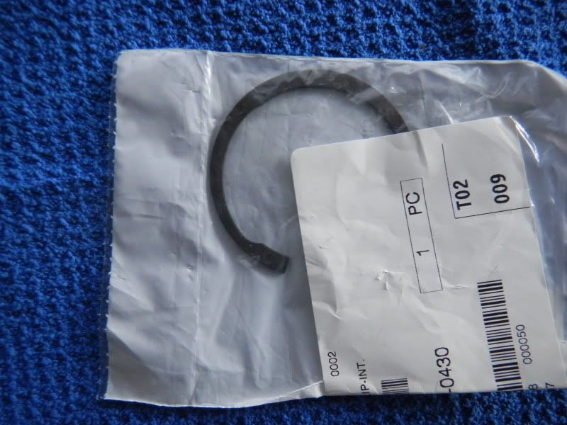

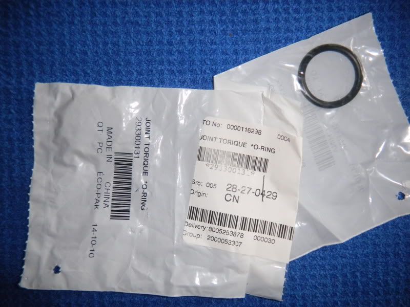

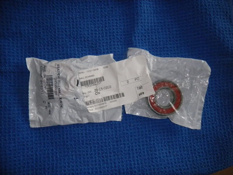

Here is a complete set for RS:
Thanks Doc and freebob
all rear bearings/seals/o-rings were replaced the week before Spyderfest as was a new tire
