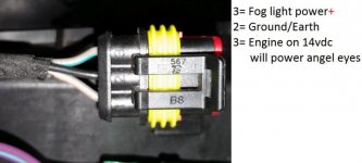

So I finally had time to start my fog lights project. I have a pair of 2.5" fog lights with angel eyes from another bike that are IP65 waterproof and they ran with no problem. The angel eyes are super bright that def good daylight running lights.
Here's my problem:
On the MX1900 male plug I'm unable to find the wire combination to connect the switch. I have 19mm 5pin switch which I plan to wire in the most common way, which will be, switch on (led on) and fog lights on. I already have common and ground figured out (red wire and black wire). The other two (grey/green stripe wire and the other black wire) both output 14vdc with engine on. I know the grey/green stripe wire is the fog light wire since the other wire on the 3pin male plug (brown/orange stripe) outputs current with engine on and that wire will power the angel eyes.
Here's my problem:
