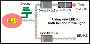

Here is a way to wire any LED to act like a dual filament Brake/Turn/Parking light. Click to see animation. I have a few of these as hi lights on my trailer.
Thanks. My friend is pretty savvy with LEDs and resistors as he has used them in other light applications on his F3.
