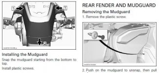

Like many others, I carry a tubeless tire repair kit in my saddlebag (which I've had to use twice on other bikes). After looking at my rear tire yesterday I realized that if I had to plug it due to a puncture access is very limited. The answer, remove the rear fender extension which gives you a clear shot to work on the tire! The service manual shows it to be a very easy and quick procedure. HAH! Easy to remove but tricky reinstalling. Of course, the first time is always the hardest but I didn't want the first time to be on the side of the road. My advice to all you F3 Ltd owners with this type rear fender - do it at home first
