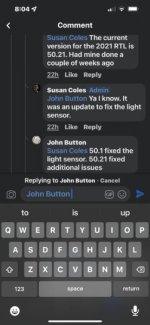

They need to plug into the bike to see the update. From what I read on a Facebook post there is even a newer update of 50.21. Hope to take my F3 in soon.

I don't know of any notifications from BRP. The dealer should always maintain the most current version of BUDS2. This will include firmware updates, that will show up to be installed if applicable to the bike. As of this writing, the most current version is: BRP BUDS2 21.1.0 (58F7 UPDATE) released on 06Jul22. BTW we now have a dedicated BUDS forum...
Not sure this is the update you are talking about.
