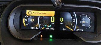

Technical question on BUDS. BACKGROUND: While investigating another problem (parking brake not releasing) I disconnected a multi-pin connector (bayonet type plug on right side adjacent to parking brake motor) that is apparently associated with the transmission functions. With this cable removed I powered up (but did not start) the bike and upon reassembly I noticed this must have tripped a tranny fault. :shocked: (my bad!) I now have the yellow dagger on the display and the recurring drop-down that will not self-clear. I have tried disconnecting the battery to reset no avail. As a standard practice, with the connector removed I covered the jack so nothing could possibly fall in to the opening. So my basic questions are:
1) Does a transmission fault require BUDS to reset (unlike active fault codes which clear when the cause has been eliminated)?
2) Any real problem operating the vehicle with the (false) tranny fault present? (after reassembly and a short ride it was shifting just fine)
Note: other than the recurring drop-down and the yellow dagger shown on the console there are no "active" fault codes.

Since the initial event I've been on several rydes and the fault is still present. I do understand that all faults are retained by BUDS (makes perfect sense) but active faults (as shown from the console menu) self-clear once the problem is corrected. Proof of this was shown to me while I was troubleshooting my parking brake release problem. Perhaps a shop manual will shed some light on BUDS operation?
I do also recall reading somewhere that there are some faults that will not self-clear but there were no specifics, implying that BUDS would be required. Hence, I was in touch with two dealers on these very questions (speaking directly with their Spyder tech), neither seemed to have experience (nor were willing to inquire with BRP) on this specific fault... they just said bring it in and they''ll see what BUDS says.

I took my RT to a dealer (an hour drive) and in 20 minutes he had the bike back to me with the fault cleared, cost only $25. This was not a fault that showed up other than the occasional drop-down warning (similar to the low fuel warning) and there was no collateral damage to the tranny function. Since the time this occurred I've put over a thousand miles on the bike and all works perfectly. Lesson learned, never disconnect the HCM connector (1) and then turn the key to the ON position. This will result in a fault that requires BUDS to correct.
