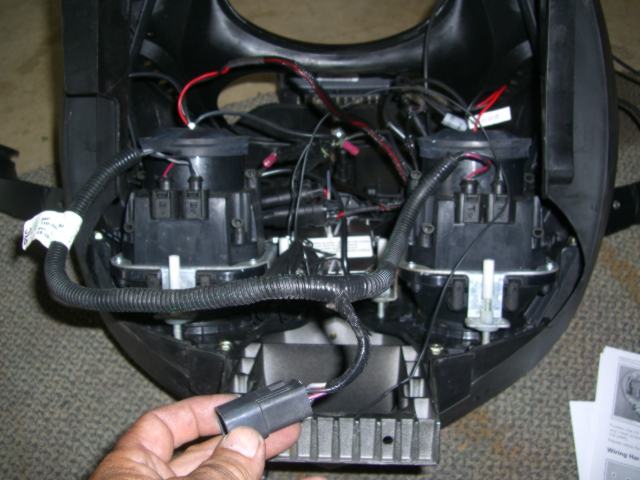

There is no way to remove just the bottom. I had mine all apart two days ago to help get the necessary cable slack for my NMN risers. It wasn't hard to take apart but I forget exactly all the steps. (Dang this old age :sour:) I took the cluster out of the top half, removed the mirrors and removed the top half of the pod. Then I think there were about 6 of those plastic locking pins that held the lower half in place. I don't recall any other bolts, clips or fasteners securing the lower pod. Once you open it up and start working on taking the lower pod off, its easy to see all that has to happen to remove it.

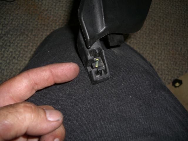

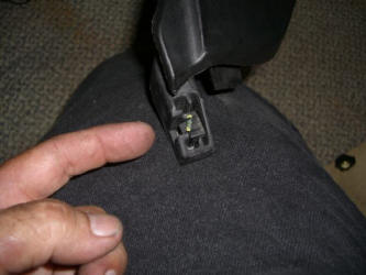

Remove Console Assembly

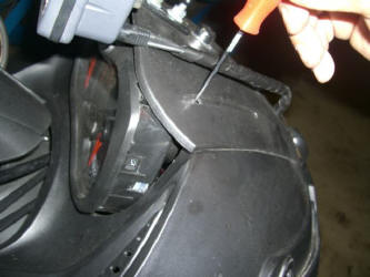

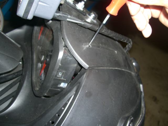

This is pretty easy deal here. Just insert a small flat screwdriver in the top of the dash and while you apply a little pressure just pull out on the top corner. Do this on both sides and the whole thing just pops out. :doorag:

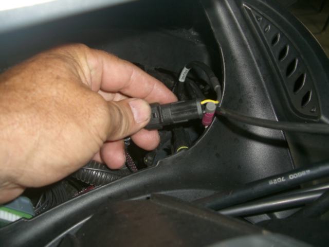

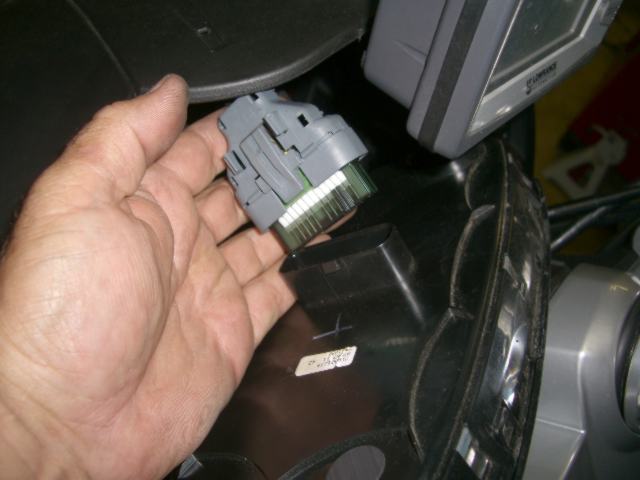

Now unplug the harness from the cluster.
Unplug both turn signals.

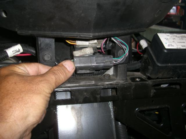

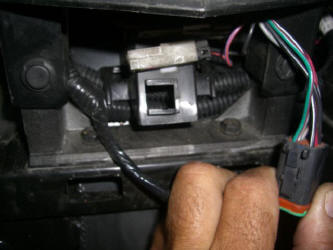

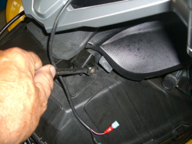

Unplug the main headlight connector and move out of the way so you can take out the two bolts that hold down the center console.

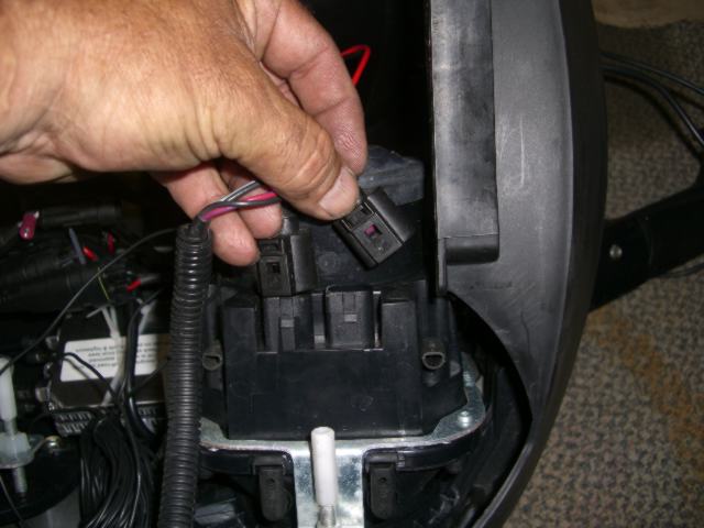

Remove the two bolts at the rear of the console and slide the console forward making sure the nuts don't fall out and into the black hole.:shocked:
Now you can set your console down on something soft and remove the stock wiring harness.
