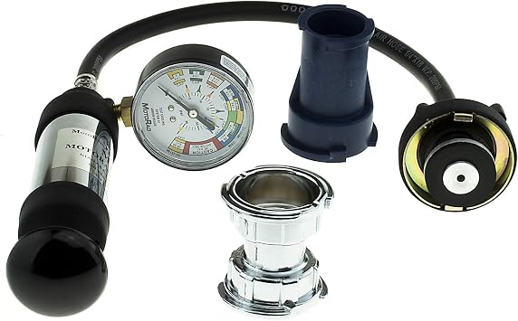

For what it is worth, most of the auto parts stores and some garages have a cap testing device. The cap is tighten on the device, pressure is applied, and you are able to see the PSI when the pressure releases on a gauge. The parts places will usually test your cap for free.
