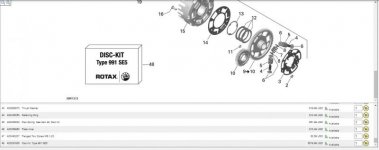

Yes there is a clutch kit available. A little pricey. Surprised you are not getting a speed mismatch fault. But your symtoms do point to a clutch failure. Even with the 2013s having the upgraded, longer life clutch plates. Usual cause of clutch failure is if an automotive type oil was used. Or was run at too low an rpm, with too high a load in 4 or 5 gear. Overheating it.
