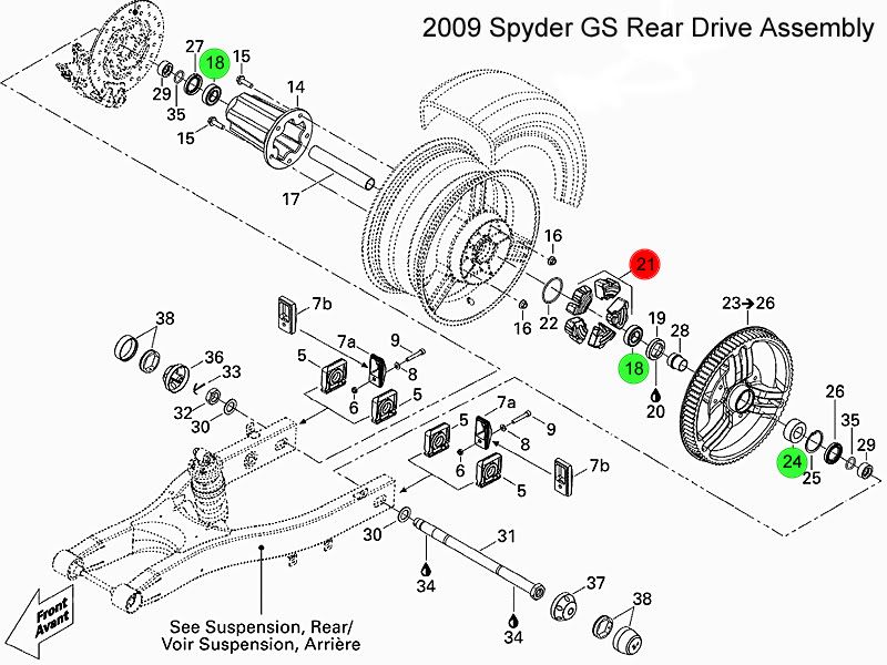

Per the rear drive assembly below, there are five dampers between the sprocket and wheel (Red - 21). Could one of these dampers failed and causing the clank? Has anyone ever had to replace the dampers? Looks like these dampers transmit all the torque, so definitely under a lot of stress! I’ve also heard that wheel bearing failures have been an issue due to over tensioned belts. Could my symptoms be related to a bad bearing (Green 18 & 24)? Finally, does anyone have any other possible ideas or things to check?

Those dampeners are rubber coated and fit in there pretty snug-- can't see them being able to make that much noise if one broke loose.
12K miles would be a good time to check/replace the bearings and seals anyhow - especially if you were running the higher belt tension for most of those miles.

I'd be inspecting the rear bearings and seals ASAP. You can inspect the dampers at the same time. Also look at the drive sprocket for possible sprocket/shaft damage. As Firefly said, it might just sound like it is coming from the rear wheel.

While on the topic of those dampers, what exactly do they do? I'm guessing they reduce vibration, permit smoother starts, etc. but not totally sure. Also, how are the Spyder's dampers constructed? My thinking is this: If they have a metal core encased in rubber, perhaps one split and that is the source of the pronounced clanking sound.

My thinking is this: If they have a metal core encased in rubber, perhaps one split and that is the source of the pronounced clanking sound. Paul
I doubt it. Bearings or front sprocket are the ones. :doorag:
As a follow-up, the problem did turn out to be the rear pulley bearing (Item 24). While disassembled, the mechanic also replaced the remaining two bearings along with new seals. Since my belt was over tensioned at the factory, everything was covered under warranty.
BTW, to check for a bad pulley bearing on your Spyder, try this test: Firmly grasp the rear pulley at about the 3 & 9 o'clock positions. Next, simultaneously push with one hand and pull with the other and alternate repeatedly. When the pulley is wiggled in this manner, a bad bearing will likely 1) emit a creaking sound and 2) have noticeable play (focus on the narrow gap where the pulley and rim interface).
