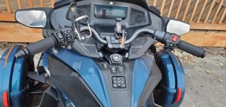

IDK what BRP was thinking with those bars on the 2020 RTs !!! They increased the length in the saddle - so unless you are an NBA all-star, those stock bars would never be within reach (pun...definitely intended). I am 5'2" and went with my beloved F3 short reach bars. While they were extremely comfortable on my 2015 F3-S, I found that they invaded my space on the RT. Remember, we sit more "on" the RT (even after the sporty re-design). I found that the short reach bars felt like they were in my lap. Found a great set of F3 stock bars (position B) in orange on eBay - got them for a garage sale price - and they not only added some pizzaz to my Chalk 2020 RT Limited...but, they are way more comfortable.
Your grip cuffs (the "clamps" that hold the grip assemblies on) are mounted backwards, bro. :) Ya gotta flip them around. The flat side needs to be against the grip assemblies. The tapered side goes towards the middle of the bike/bars.

Ha :) Good catch
