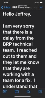

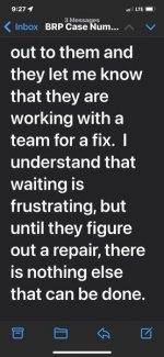

I know you’re in pain. I have a new 2024 Spyder RT Limited. I bought it Feb 6, had it a week and it didn’t want to go into reverse. It has been at the dealer ever since. The dealer started a claim with BRP and have been reaching out to them for guidance. BRP stopped responding over a week ago.
I have called BRP 8 times and complained. BRP sent me an email today saying that they essentially don’t know how to fix it. They have a team studying the problem and when they get a fix, they will let me and the dealer know.
Here's the email.
