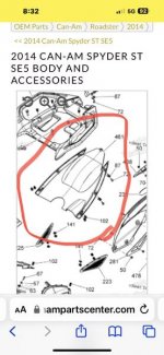

Yes. It's the circled part in the fiche.
