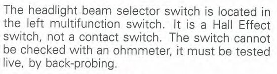

2010 RT SM5. Out for a ride stop for a break. Went to start the bike, but when touching the mode button, the safety message would not go away. After many tries, the message didn’t display and I was able to start up and get home. At home, trying to start got the message screen again. When I tried to start today, the safety message didn’t display and I was able to start. While letting the Engine run, I found the following. The Mode button does not cycle through all the different modes; the turn signals are not working; the headlights are on, but won’t go to high beam or flash; the trans will not go into reverse; and the up, down, left, and right buttons are not working also. Anyone else experience this?
