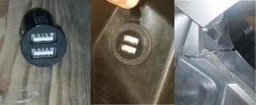

Any options to get a USB Outlet For Passenger?
nicely done! If you are in the least bit concerned about water or road dust getting in there, a search around some places like AutoZone, O'Reilly's or NAPA, you will find various sizes of grommets that are either whole or split to fill the rest of the hole not taken up by the cord. (the whole ones are easy enough to split with a razor knife). However, I'm thinking the placement alone is sufficient to alleviate any worries along those lines. :2thumbs:
I’m just going to have to take time to take the passenger backrest off and check out my options and “try” to work up the nerve to drill a hole in the trunk.
I don't blame ya! I put a usb plug in my 18 that was right up on top of body near glove box...must of looked and rethought it for half an hour before I could pull the trigger on the drill!:pray::thumbup:
