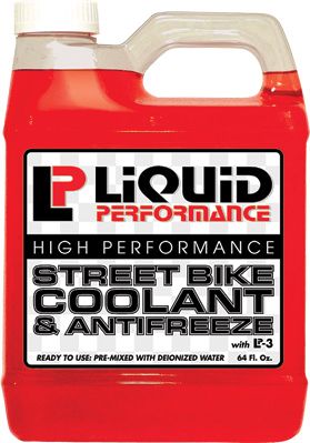

Have you tried this? Though I have not had heating issues I may give it a run after a bit more research. The chart does not compare this product to standard anti-freeze/coolant. But you'd assume it would be higher than any of the tested products. Then again, you know what ASSUME(ing) will get you!
An important item that is always a question with high performance coolant products is boil-over and freeze protection. This one has very good numbers in that respect also.
  • Note: Boiling point protection up to 260°F (126.6°C); freezing point protection down to -30°F (-34°C).
I am not promoting or even recommending this product because I have not tried it myself. But it does look very interesting.
LIQPERF-COOL-02_is

Who carries this antifreeze? I have to change my wife's coolant in her 09 GS this year and maybe I will put that in if I can find it. I go over to the US a lot so getting from a US retailer is not a problem.
If you go here and click on distributors:
http://www.liquidperformance.com
They list a Canadian store- Parts Canada- along with a number of US stores, and online stores.
