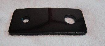

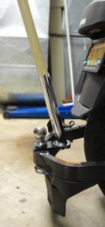

I made this for my old RS (I had the after market hitch), and I was able to fly a 3 x 5 flag @ 75 mph with no issues. I took a 6 foot 5/8 threaded bar, use nuts, and washers to hold on the clips. To make it look good I slid the pole from a cheep flag pole over the threads, and bolted it onto the hitch.
