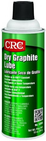

I will add that you need to find something that dries without leaving a sticky film. This will only attract grit and dust that will over time cause problems. I use a silicone or graphite dry lube.
WD 40 IS NOT RECOMMENDED FOR PLASTIC
Use silicon spray
Of course use what you wish but check the label, this is not regular WD-40. From the WD-40 website:
WD-40 Specialist® Dry Lube
4.50 (84)
WD-40 Specialist® Dry Lube with PTFE is a dry lubricant that keeps your equipment running smoothly with long-lasting corrosion protection that does not attract dirt, dust, or oil. It provides superior lubrication and long-lasting corrosion protection with no oily residue. Best used where cleanliness and maximum performance are required as it dries quick leaving behind a lubricating film that resists dirt, dust and oil buildups. Great for reducing friction and wear on blades and bits, door and window tracks, slides, conveyor belts, rollers, hinges, table saws, lathes, power tools and equipment. Effective in temperatures ranging from -50°F to 500°F.
