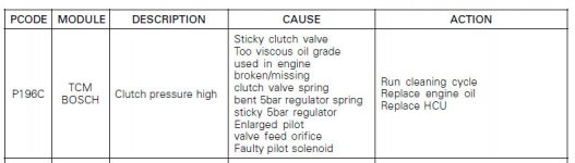

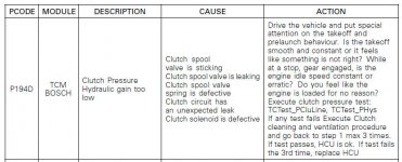

We went for another 200ish mile ride today and it threw the 3 codes listed above... the original plus 2 new ones. But the P196C and P194D codes don't show up in any searches. Anyone run into these 2 before?
Hoping it's just from the break-in still and I know stuff happens so not getting too worked up about it yet, but... My Wife's 2018 F3T hasn't had a single issue... running like a top. So just my luck I guess on the 2020...
Anyway, some idea on those 2 codes would be helpful. It will likely end up back at the dealership sometime this upcoming week...
