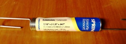

It might just be that the spring that's meant to return the pedal &/or associated brake light switch to the fully off position has just become a little weak over time - this was a common problem a while back, altho not seen quite so often in recent months.... :rolleyes:
But still, if that spring isn't pulling back quite as hard as it once did, your brake lights will probably stay on longer than they once did, and that'll have nothing to do with the module or even the micro-switch.... it's just a tired spring! ;)
Check out the info on the pic below - that's a pic of the spring many here have used as a 'helper' for their 'tired brake return springs'. :thumbup:
