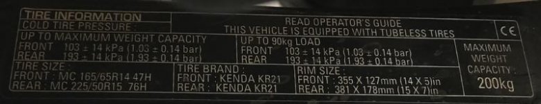

Cannot find tyre info on any stickers under seat. The manual recommends MC 165/65 R14 47H on the front and MC 225/50 R15 68H but the specifications just say 165/65 R14 on the front and 225/50 R15 on rear. No MC or H rating. My neighbour has a Tyrepower franchise and although Typrepower doesn't mention the sizes I'm after, he stocks the brands that do have the sizes. He can balance the fronts. Had that done before. But I do need an alignment.

But your Spyder SHOULD have a Tyre Information Placard somewhere (if it passed ADR's & was legally sold in Aust, anyway!! :rolleyes: ) Maybe yours is down on the swingarm? Or maybe it's been removed - in which case you could end up in the brown smelly stuff!! :shocked: You might want to search for it, and if you can't find one anywhere, talk to your dealer about getting a replacement.... do you ever need to get your Spyder inspected in Vic?? :dontknow: If so, you'll need to have that Tyre Placard fitted in the appropriate place by then, just like you need an engine number & a VIN, but in the case of the Tyre Placard, it is only a sticker! :thumbup:

Wheeled the Spyder out into the sunshine and there were the details on the top of the LH swing arm. Now it appears that I can only source these tyres via a Spyder dealer. That would appear to be a constraint of trade (illegal?). Car tyre shops (when fitting cars) appear to only fit what is on the placard or better. No brand specified. Never had a non-Kenda on front before but have had a TOYO on the back. Looking at a pair of MAXXIS MAP1 165/65R14 79H. There are others (eg. Kenda KR23) with a H rating but these are all mail-order although there is a tyre-fitter who does mail-order via Tyroola.

The Australian Federal Govt classifies the Spyder as a LEM2 category vehicle. A tyre placard must be attached to the vehicle clearly showing the rim and tyre sizes, and tyre inflation pressures applicable to that vehicle. No mention of brand. Tyres must be at least the load rating on the placard. Tyres must be at least speed rating S. So I think a car tyre is applicable. Also no mention on sidewall ply.
