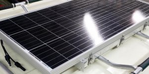

Solar panel mounted.jpg 100 watt panel puts out 5 amps at 18v under optimal conditions. Battery can readily recharge while underway to the next campground (or boondock)

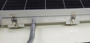

Solar panel spring latches.jpg panel is mounted with 6 spring latches, so it can be removed at campsite
