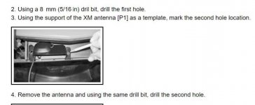

    Default satellite radio.
    Picture from the install instructions.

    I installed a satellite radio myself, that's the antenna. I moved mine to the top of the trunk for better reception
    I see something that concerns me a little bit...
    Your antenna cable hangs underneath the strut that holds up your top trunklid.
    Could you re-route it, so that's it's above the strut?
    (I'm just concerned that the strut is working against that cable, and could wear a hole through it...)
