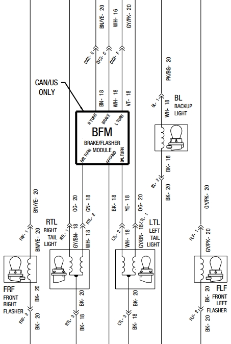

I have a full-function (tail, stop and turn lights) LED lighting kit by AdMore installed in a Givi top box I've mounted on my F3-S. These supplement the stock lights, adding considerable conspicuity to the rear of the trike. System worked great when installed on a motorcycle previously.
I'm now switching the box over to the F3 (using the killer rack that Maurice at www.mblinnovations.com manufactures).
I'm having difficulty locating the proper positions along the wire harness to insert the Positap connectors. Between a black box module that has white brake light wire and brown tail light wire running in one side, and yellow/green turn signal wires coming out the other, plus the basic right hand side and left hand side pigtails that run from the module to the separate halves of the tail light assembly, I'm playing hit-and-miss with finding the correct place to "splice" into the harness so the three functions are correct.
So far, all the LEDs light up, but not quite as intended.
Anyone gone down this route who can help?

From Admore: +12V & ground made at accessory plug under passenger seat. All other connections made just before the BFM. Strip back a bit of tape and use positaps. Worked great for me and has about 3500 miles on it and still ticking as it should. Hope this helps.
AdMore LEDV56-T-TS Function Spyder
Red Switched +12v OG
Black Ground BK
Blue Brake light mode WH
Green Right turn indicator BN/YE
Yellow Left turn indicator GY/PK
Bob
close, but no cookie
Bob:
I appreciate the assistance, and get the basic concept.
However, the AdMore cable I am connecting has SIX wires in it, and in it the purple one is the brake light function; there's both a red and blue, which AdMore says go to a common 12V feed connection.
I believe I've done as they and you suggest, with regard to the BFM module (or at least what I presume to be the BFM module!), but I'm getting yellow flashing LEDs for brake instead of a red LED consisting of three short flashes and then solid red.
I've written AdMOre tech for clarification with regard to my particular product.

I'm dredging up Pete's thread. Wondered if anyone, since Pete had, successfully migrated an Admore equipped Givi Top case from another bike to their F3-S.
I've had the Givi V46 and Admore's LEDV46-T-TS (CG) LIGHT KIT mounted to my Honda NT700 for several years and the Admore kit lights all work as advertised. Moving the Givi case to the F3S, I used the info from Bob per this thread, to determine where the power, ground, brake and turn signals should be connected (prior to the BFM). I used posi-taps to make the connections. I've used a test light at the posi-taps, and brake and signals all come on as expected. Next, connecting the Admore tunk lights, showed they sorta work... I get no running lights. Brake lights work, but turn signals only work when the brake is on. That indicates to me the trunk case turn signals are not seeing ground unless the brake lights are on. Maybe similar issue with the running light function. I've tried using the 12V battery dirctly for 12V and GND, but all acts the same. I tried picking up the turn signal from just before the bulb, and reaction is the same. Wonder if this disfunction has something to do with the CAN Bus.
I did set the Givi case up so it could be moved to either motorcycle by using a 5 pin (prewired) waterproof set of connectors. Once installed on both cycles, I tested it on the NT700 to make sure everything worked as before, and all is good.
I'll contact Admore for some help, but would appreciate any wisdom from the group, I'm OK with vehicle electrics, but electronics is not a strength. I'm hoping there is a solution to allow the tunk to be easily shared between cycles.

For anyone who tries this, and you have a 5-wire Admore harness, instead of 6, you'll likely have an issue like I did..
After no response from the forum, I contacted Admore last Saturday, and they emailed me early this morning, Monday. The tech asked whether I had a 5 or 6 wire harness, and I replied it is a 5. He responded within 30 minutes and told me to swap 2 wires. Success! I'll not say what the change was, it was a bit odd, and if anyone has a similar issue, please contact Admore on their website under support, or at support@admorelighting.com with your specific case and harness. I wouldn't want to give misleading advice.
Kudos to them for such a quick reply and solution!

Two subjects here.
First, the wiring switch I had to make. The original Admore kit was for the Givi V46 Topbox. It had been installed several years ago on my Honda NT700 and I set it up on the F3S, with the Baker rack.
The Admore kit wired to the V46 was a slightly older model with different controller than the newer universal kit they sell for the Can Am Spyders. The wire swap that was advised was to swapt the red (+) and blue (brake light) wire connection. In other words, connect the blue brake light Admore wire to switched power and the red Admore power wire to the brake wire on the Spyder. This will only work if the Admore kit is the earlier version. I did get the SH 36 bags and the new Admore kit was initially connected the same way the Givi case was. It did not work. I switched the red and blue Admore wires to match the instructions, for just the SH 36 kit, and all works well now.
