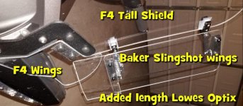

    I added the F4 lower wings and the Slingshot Baker wings to my new braced (must be the new F4 mounts) F4. I extended the Bakers using Lowes Optix acrylic clear cut to size with a utility knife and a metal straight edge. Holes drilled with a forstner bit and then bent by heating with a heat gun using the same straight edge. Best improvement for the audio unit to date.
