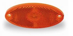

    found these jewels that appear to just about an exact match. problem is they are from across the pond. the price for two would be $47 and that would include shipping.
    https://www.leisureshopdirect.com/el...ts-series-2012
    2015 RT Limited Intense Red Pearl

    Default Nice, those do look like the ones....
    Quote Originally Posted by DJFaninTN View Post
    Nice find.....maybe Darin could help with the getting them across the pond?
