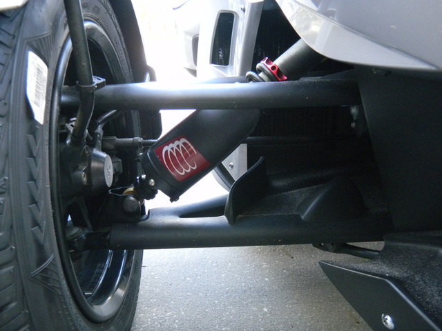

    1,214
    Default Spring adjusters
    The spring load adjusters are collars that mount on the stock shock tube. I do my own mechanical work. Very easy to install.
    I have my preload set at 2 revolutions. For heavy loaded moto-camping I will go to 3 revolutions.
    See BajaRon's site on the SpyderLovers home page.
    2013-2016 ST & RT Front Shock Spring Adjusters (Only for those Spyders WITHOUT Factory Front Shock Pre-loadAdjusters)
    Coil Spring Adjusters allow you to quickly and easily adjust the amount of pre-load (stiffness) and ride height of your Spyder. This not only helps to control lean and dive but brings yourSpyder back to the proper ride height giving your more ground clearance which avoids hitting the front of your Spyder on speed bumps, driveway approaches,etc.
    email Ron at fyredad@hotmail.com or PM Ron here atSpyderlovers.com
