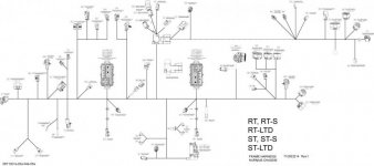

    Found the wiring diagram on page 751 of the shop manual.

    Number 4 is North America fog lights or CE low beam. There is a matching one on the other side. ST and RT have the same frame harness so there are a lot of orphan connectors.
    On the frame harness look for the right style connector. Then compare the identifying code with the wiring diagram. That should tell you what it is for. You may need to look at RT wiring diagram for options that are not available on a ST.
    Frame Harness Diagram
    Good luck.

    Spyderlovers shrinks the diagram so here is a link to a better version. https://drive.google.com/file/d/0B9z...ew?usp=sharing
