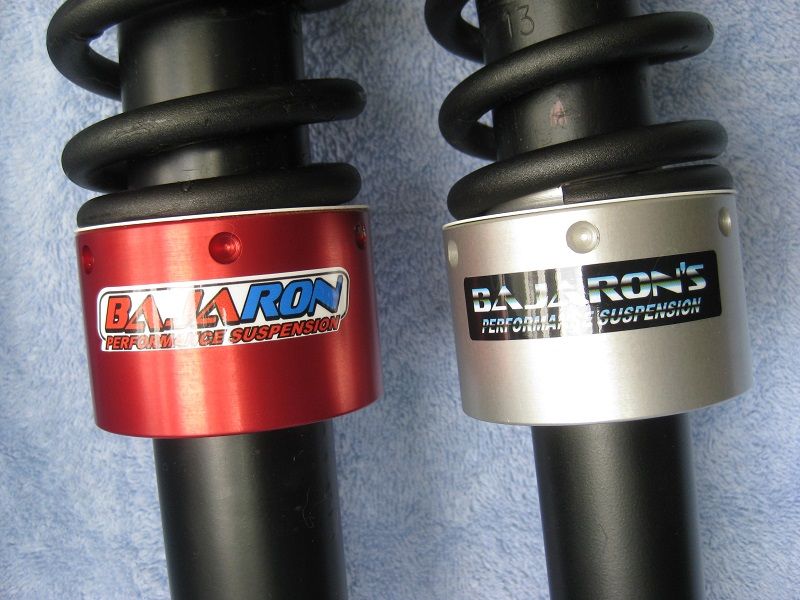

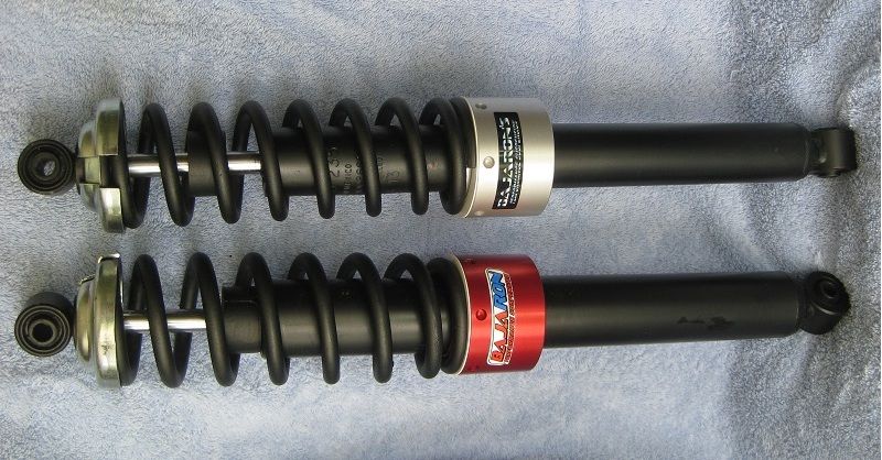

    There are other alternatives out there. But this is what I offer. Fully adjustable (threaded) units that install on the existing OEM shocks. They work great! These will keep the front of your Spyder at the correct height loaded or unloaded. They also reduce sway, lean and dive in corners and while braking.
    They come in Red, Silver and Black (not pictured)
    I no longer scrape at the end of my driveway with my BajaRon Adjusters. Mine are red which is clearly the best color. We have installed two sets and the install isn't too difficult. It helps to have a second set of hands - might be a little difficult to do on your own. Another quality product from BajaRon.
