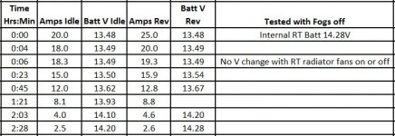

    Default A Test Update
    An update to this thread, I wanted to see how well our 2014 RT Limited would charge up our "camping battery", which is a 12V, 35AH sealed AGM. I discharged the battery to a safe level then connected it to the Spyder with large gauge cables, engine running at idle and revved up. Below is the charging measurements observed. As you can see there is not much difference between idle and with the engine revved up.
    This alternator is, for a motorcycle, a powerhouse!

    Very Active Member spyderCodes's Avatar
    Jan 2016
    PA
    691
    While the theoretical total amperage delivered by the alternator is around 87.6 A you probably couldn't really draw anything near that for extended periods in the real charging system so I wouldn't be trying to use the microwave and the popcorn maker at the same time.
