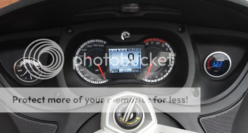

    So I've now fitted both replacement gauges, wanted to keep it simple with no mess. Installation took about 1 hour. First pic is with the ignition key in the on position and the voltage showing is the output from the battery. Just one word of warning, when your looking for a replacement gauge don't buy a long body replacement gauge (they don't fit snug). The volt meter shown here was not the original intended gauge. The first one I bought had a really long body and it didn't fit so back to ebay and found this baby which is the same as the one shown on the youtube clip.
    This next pic shows the charging voltage which is really handy,

    Hi, yeah I got the clock from Ebay it wasn't expensive , just search eabay for a 52mm analogue clock and it should come up in your search box, :-)
    I went with a replacement clock on my fuel gauge because it was easier to do this rather than cutting into existing circuits or oil lines. But you could choose an Amp gauge.
    The point of replacing the fuel gauge with a clock is not because I wanted a clock more about I wanted an accurate reading of the fuel left in the tank. If the fuel gauge was accurate insted of bouncing all over the place I wouldn't change it. However now that we have I', really happy with it.

    the clock only works when you turn the ignition on. I have a button lowerdown near the speaker that when pressed sets the time. I didn't want the clock to be permanently powered because a lot of the time it's not being used, but thats not to say you couldn't wire it up to work constantly, i used the +/- power cables from the wires feeding the lights on the original gauges, the clock is analogue and the volt gauge is digital. We spell analogue this way in the UK.
