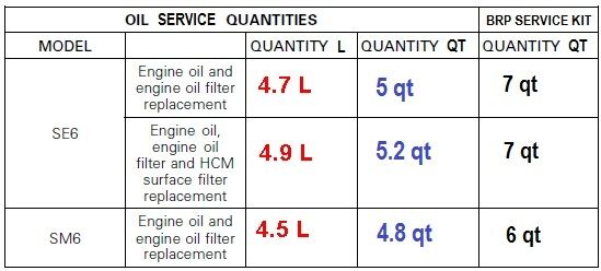

    A reasonable approach. But still doesn't explain 7 quarts in the SE6 oil change kit from BRP.

    could chime in and put this to rest. Would be nice to have the proper oil amount!!

    Default BRP Care already posted about this subject on 10/10/2014
    Quote Originally Posted by wis2013rtltd View Post
    Steve went into great detail on the proper way to check the oil level and in post #23 he also published the correct oil capacity.

    Quote Originally Posted by Orange Spyder Man View Post
    I'll follow the owners manual recommendation until BRP changes what is printed in the manual.. warranty purposes... what's the old saying "CYA"
    osm
    BRP did send out a notice to dealers and techs, I think in March of 2014. They had a revised version of the service manual that was to be printed off. It had these changes published inside.

    Default Less Oil
    I thought I was seeing things when I checked my oil this past weekend. The oil did not even show in the Minimum range on the dip stick. Bought oil yesterday and little at a time put in maybe half a qt. of oil. I now have oil registering two lines above minimum and the spyder sounds smoother - go figure right !
