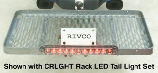

    Site sponsor Rivco makes two quick release trailer hitch racks that are ideal for carrying additional luggage. The rack mounting plate is placed beneath your hitch ball and the rack slides into the receiver in seconds. I have used both Rivco racks in the past and can attest to their functionality and durability.

    Good idea but I doubt it would work on the Spyder as intended. Both the BRP and after market hitches have a ball mounting plate that is probably too wide for this bracket. You could use it if you're willing to remove the ball to install this anytime you want to use it. That wouldn't be too much of a hassle since it only takes about a minute or two to remove and reinstall the ball, and you wouldn't use this and the trailer at the same time.

    If you look at the picture on the left you can see that the ball hitch is in place. this item works great.

    Correct, I have used both racks at one time or another on my Spyder BRP hitch as well as a Denray Hitch I had on my RS Venture and Goldwing GL1800. Remove the hitch ball, mount the plate, re-install the ball and it remains on the bike and does not interfere with attaching various trailers, including the RT622 trailer.
    It is an option for when you don't want/need to tow a trailer, although it is recommended that you keep the load weight within reason.
    Wish the OP good luck in finding what works for them.

    Are we talking about the same bracket and rack? The one with the round tubes? The bracket with the round tubes would have to be mounted on the top side of the Spyder's ball mount with the tube receivers facing up, right? Are the tube receivers small enough to allow a trailer tongue to move over them, or do you have to put a spacer between the ball and and bracket to give clearance?

    If you look at the picture of the Rivco bracket in the picture above this would normally be the way it would face if you mounted it to the hitch bar and passed your hitch ball shaft through the bracket hole. Since I also pulled the RT622 trailer at various times, I found that the addition of the bracket added a few inches of height to the ball position when mounted. To counteract this I flipped the bracket over when I mounted the ball bringing the hitch ball pretty well back to its original height on the tow bar without the bracket. The trailer tongue is well above the rack tubes either way and did not require a spacer.
    All that being said, the Ebay hitch mentioned in s recent post appears to be a great alternative at less than half the price. Nice to have options.

    Thanks. I guess I need to go look and see just how much vertical space there is between the trailer tongue and ball mount surface. Obviously there's more than I was thinking there would be.

    Before considering the Rivco unit contact them as I recall from a previous post that they do not recommend their unit for use on the Spyder. Something about the weight being unsprung could cause the rack to fail.

    Thanks for the kind referrals Spyder lovers, we appreciate the thoughts, but as mentioned above, we specifically DO NOT recommend our racks for use with the Spyder's un-sprung hitch (it's in the description of the parts on our website, and in the instructions). Even with our strong racks and hitch connectors, there is too much stress with all the shaking and vibration. Sorry!
