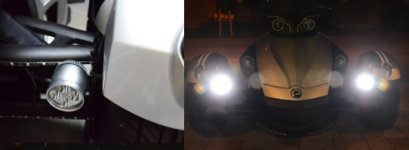

well what I did. Adding lights on lower air dam angling the fogs to the edges and driving lights straight ahead. You may just want one set....
20121227_185656.jpg separate controls 20130108_113301.jpg good luck..!!
