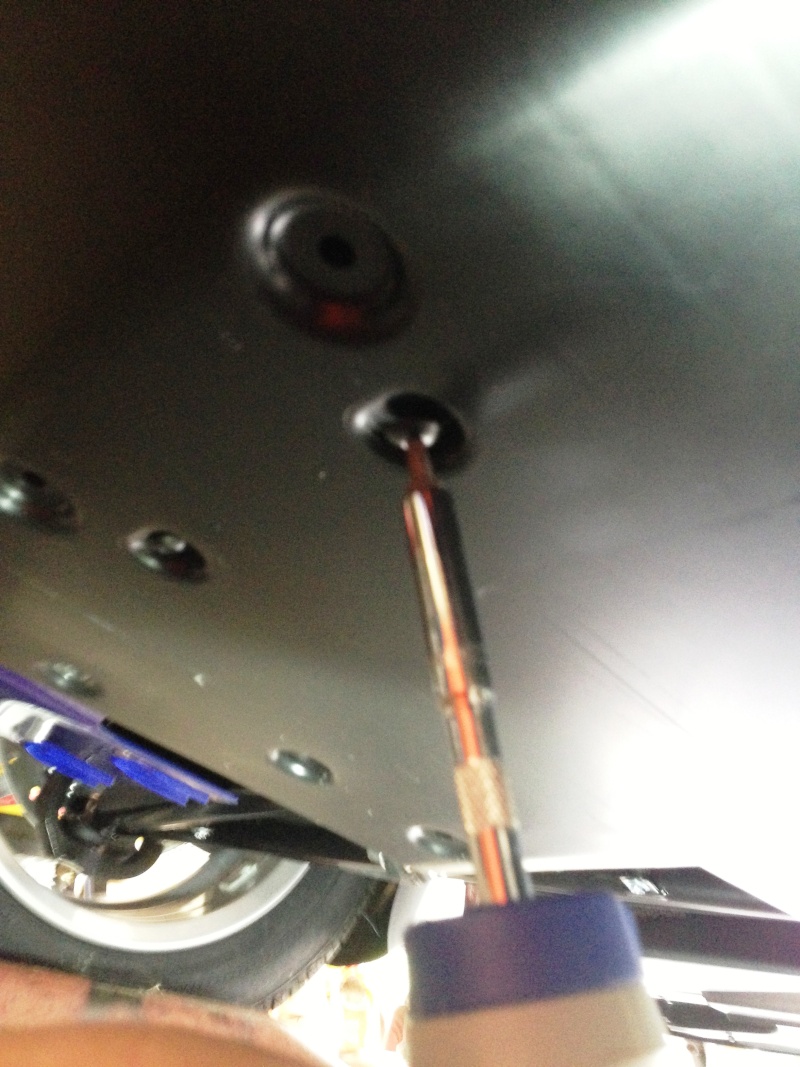

    Today I did my first modification to the Spyder by adding a SpyderPops Bump Skid. Installation was very simple. First remove the factory skid plate.

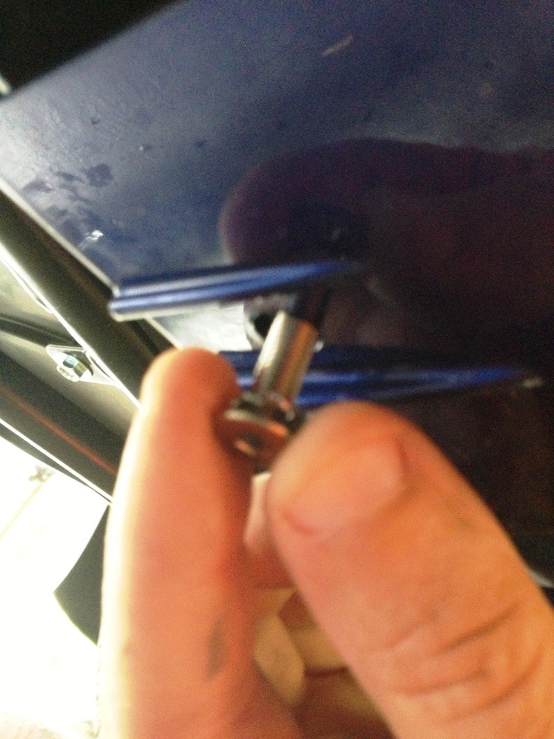

    After removing the skid plate, I simply followed the enclosed instructions removing the plastic 4 rivets on the wings.

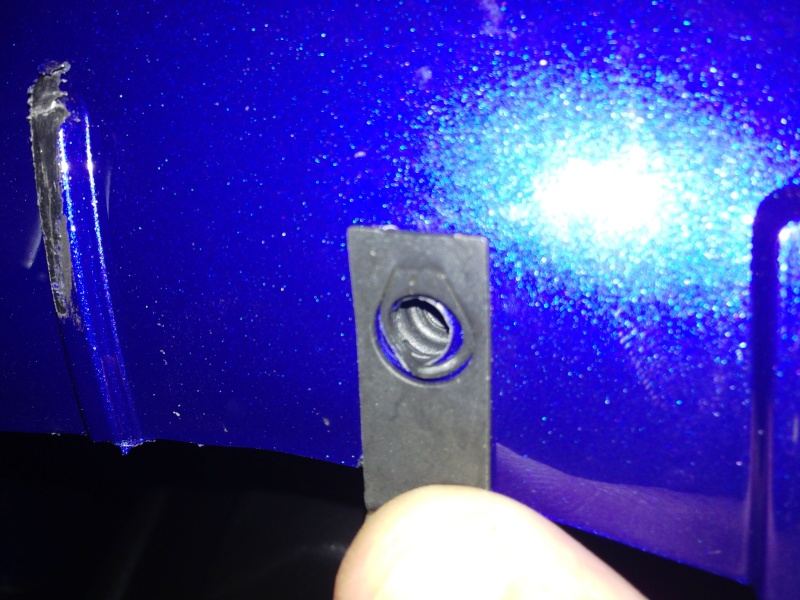

    I then added the clips to the 4 holes where the rivets were installed making sure that they were centered in the holes by testing each to make sure the bolts would thread properly.
    I installed the bump stop using these 4 holes at the wings and snugged them up so I could use the bump stop as a jig for drilling the 8 - 1/4 inch holes in the front of the bump skid as well as the 2 in the rear.

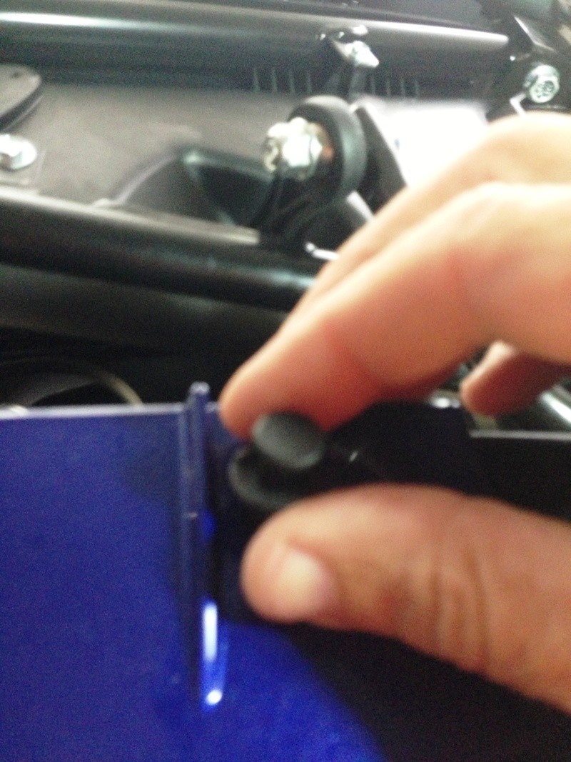

    I removed the bump skid and placed the clips over the holes again making sure that each was centered.

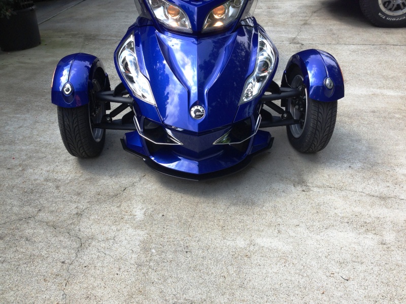

    I then removed the clear plastic protection film and installed and tightened the bump skid going around in a pattern so that it would fit secure and evenly. (The crack is a reflection of my garage floor..oops)
    The fit and finish is awesome. I am glad I chose SpyderPops.

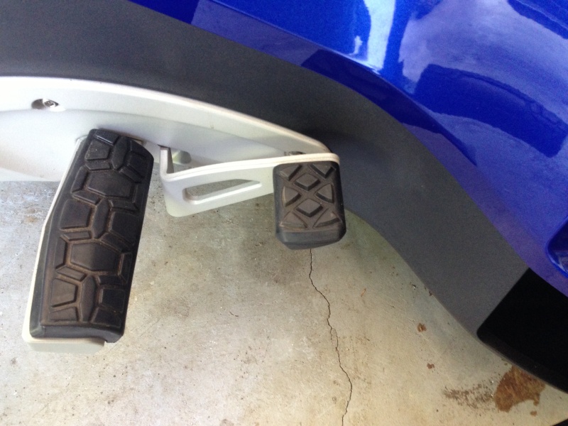

    The rear boards took a total of 3 minutes to install. Removing the OEM rubber.
    Then bolting the new boards on with the supplied bolts.
    Now the finished product. All in all I am very happy with the install.
